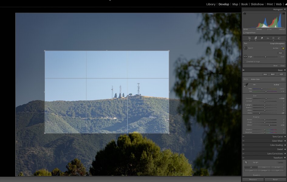

As far as I know Lightroom is unique at this time and other photo editors only display un-cropped RAW images. Here is what the Lightroom Develop screen looks like for a RAW Hybrid Zoom photo, with the Crop and Straighten tool selected. Note that the full un-cropped image is displayed, and the Hybrid Zoom cropped region is highlighted. Also I had previously moved the Hybrid Zoom cropped region - it is NOT centered - I moved the crop zone of the image a little to improve the framing. (Also note, at this point the cropped region can be modified to any size , shape and position desired - with the Hybrid Zoom crop as a starting point.)

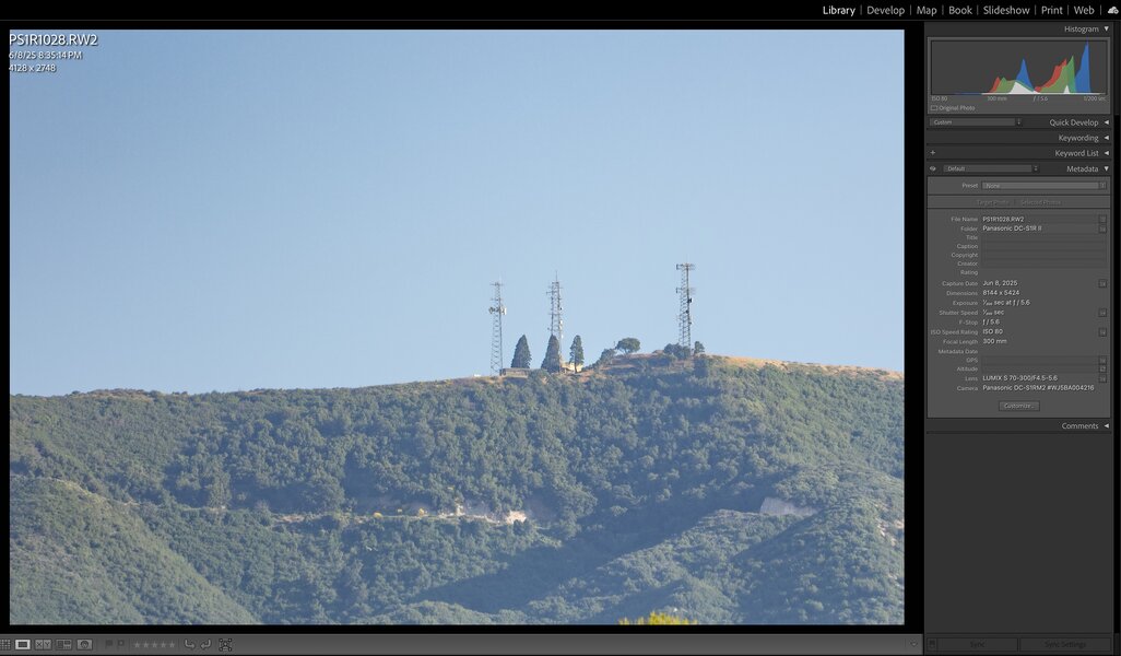

Now looking at Lightroom's Library view, the zoomed RAW image is displayed, indicating the image size. Note the cropped image size is at the upper left, 4128 x 2748. While the captured image size is shown in the data at the right, 8144 x 5424.

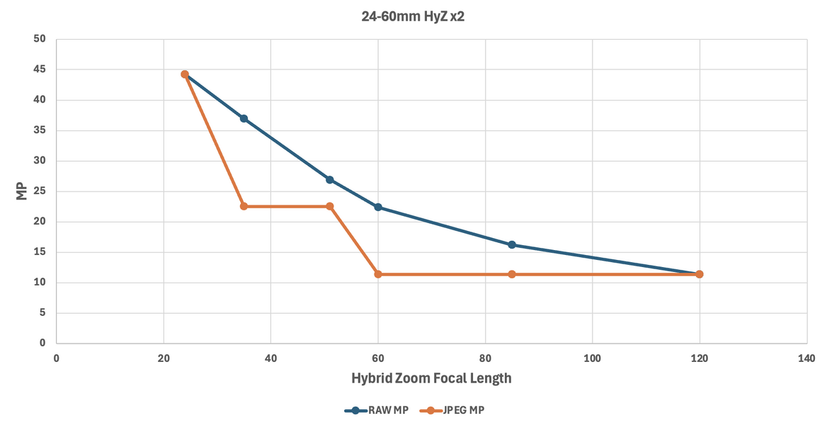

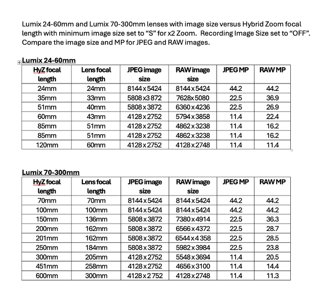

I looked at two lenses, the 24-60mm and the 70-300mm, and took photos varying the Hybrid Zoom focal length indicated by the camera in steps from full wide angle to full telephoto. I noted the actual lens optical focal length for each Hybrid Zoom focal length as shown in Lightroom. And then I used Lightroom to measure the actual image size for both the JPEG images and the RAW images. Here is a table with that data. Note that the JPEG images and the RAW images act differently. The JPEG images are placed in a series of fixed image size buckets, while the RAW image sizes progress smoothly from full wide angle to full telephoto.

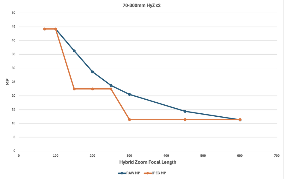

The process of having the JPEG images in image size buckets can be understood a little better with graphs of megapixel image size versus Hybrid Zoom focal length. First the 24-60mm lens.
Then the 70-300mm lens where it is a little more obvious.
For the JPEG images the camera processes the images into fixed reduced image size buckets until the image would be too large to fit that bucket size and then it steps to the next smaller bucket size. And there only two image size buckets smaller than the original image size.
RAW is a different story. The image size is the same as the Hybrid Zoom crop size, and it varies smoothly throughout the zoom range. In every case the image size is greater with RAW than with JPEG except at the points where the JPEG image size would equal the RAW image size.

The RAW files are NOT cropped, they are always 44 MP. And the crop region information from Hybrid Zoom is embedded in the RAW file EXIF data. And Lightroom can show the crop region.
See my first Lightroom example of the Develop page above, with the Crop and Straighten tool selected. Note the full 44 MP RAW image is there, and the crop region from the EXIF data is highlighted. If you want to use the entire 44 MP image you just fully expand the crop region manually - you un-crop it. Or you can modify the crop region however you want; bigger, smaller, move it around. When you close the Crop and Straighten tool you see whatever is in the cropped region - up to 44 MP if you fully expanded the crop region.
To be clear, for RAW this is no different than normal Crop and Straighten in Lightroom. Hybrid Zoom just gives you a crop starting point that equals the effective focal length you selected for the picture. I realize this can be somewhat difficult to explain clearly, and let me know any questions.

The only thing I don't understand is why you have a "Raw MP" column in your tables. Shouldn't that always be 44 MP? What is it that you are trying to communicate here?
As they say, good question. Look at the first Lightroom screen shot that is in the Develop mode and using the Crop and Straighten tool. The full image there is 44 MP. But the highlighted part is the crop boundaries. What the "Raw MP" column shows is the number of MPs within the crop boundaries. That column shows the MPs within the crop boundaries versus the Hybrid Zoom focal length.
Again, if you forget about Hybrid Zoom and just go in and crop an image, it is the same thing. The 44 MP image remains, but the cropped portion has less megapixels.
I was trying to convey it is not as great for JPEG shooters. The camera bins JPEG images into lesser megapixel categories. But it is a great tool for RAW shooters. I expect I was trying to cover too much with this one post, and it probably needs a White Paper that properly introduces each topic.
OK, NOW I get it. That is interesting. You get more pixels from the cropped raw file than from the JPEG. I assume they have the same field of view? Very odd.
