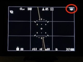

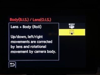

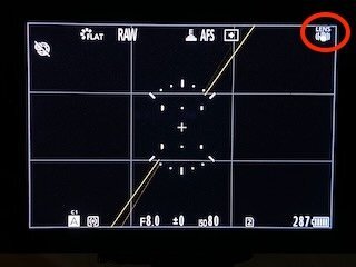

S1Rii + 100-400 (Lens + Body IS):

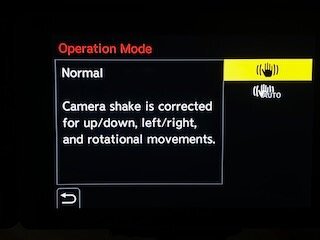

S1Rii + 24-105 ("Dual" IS):
The "Dual" definitely works better (well, to be precise, the S1Rii + 24-105 works better). Taking shots at 1/3s at 105mm on both lenses delivers mostly sharp images from the 24-105 but mostly blurred images from the 100-400.
But what exactly is the difference? And why doesn't the 100-400 support "Dual"? I thought the whole promise of L-mount (compared to m43) was that all L-mount providers/licensees are "first party" and so support the same standards. None of the m43 madness (aperture rings, dual IS, etc).
