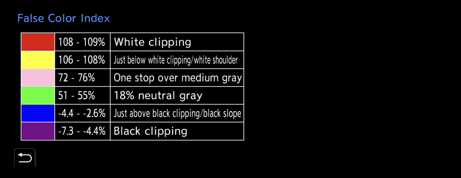

The S1RM2 has a new function for Panasonic mirrorless cameras, setting the exposure with FALSE COLOR. This can be used with either the Photo Mode or the Video Mode. FALSE COLOR is usually used on high end video cameras, and I've seen it on Atomos video recorders, but have not used it. But it is potentially very interesting - you look at the whole scene on the monitor or viewfinder and know what parts of the scene are over exposed, or under exposed, or just right. An old alternate to expose for best dynamic range is the Expose-to-the-Right (ETTR) method. But it is not very consistent or accurate. For quite some time Panasonic has had the Waveform Monitor; this has been my go-to method to set exposure for video. Unfortunately this is not available in the the Photo Mode. I almost always expose in the Manual mode and see the potential with FALSE COLOR to accurately set exposure for both Photo and Video. I have not used this very much yet, but I'm hoping with experience this will become a fast and accurate way to set exposure. I'll probably be using the Waveform Monitor as a crutch along the way.
With FALSE COLOR the image colors on the screen are divided into six categories to represent the luminance levels. Here is the False Color Index from the camera menu.
Presumably FALSE COLOR works directly off the Raw file & not a compressed Jpeg thus giving you a more accurate exposure readout?
Looks like a great feature & will assign to a custom button,
Sigma have this on the fp L. I have one of the buttons customised to show False Color while held down and find it to be far more useful than the usual zebras or histogram since I can immediately see exactly which parts of the photo are likely to be overexposed or underexposed. I'm really pleased to see Panasonic have implemented this in photo mode on the S1Rii.
It is after the color style, but the false color index is adjusted to reflect the style. This is pretty sophisticated if it works, but I have not thoroughly evaluated it.
I’d be very surprised if it’s off the raw data, but if it is, that would be a killer feature for landscape shooters to maximise DR. An easy way to test would be to vary the picture styles (flat, portrait etc) and see if the false colours change. If they do, it ain’t the raw data!
It’s worth mentioning that Olympus cameras have an over/under indicator system that uses orange and blue for over/under respectively. I liked that feature and was surprised that most other manufacturers provide only Zebras, or in some cases nothing at all in live view (e.g. Nikon).
Yes, I suspect we'll need to setup a style that best emulates raw data to use effectively with this, just as we have to do with zebras, blinkies, etc. At least, if you are a raw shooter.
I've been meaning to experiment with the false color, so thanks for posting Charles. Perhaps I'll assign it to the Most Annoying Button Ever (a.k.a. the red Record button on the front of the camera).
As I mentioned in the post above, it is not off the RAW data, but after the color style. However the FALSE COLOR INDEX is adjusted to reflect the style. This is a pretty sophisticated approach.
I've been meaning to experiment with the false color, so thanks for posting Charles. Perhaps I'll assign it to the red Record button on the front of the camera.
Yes, I have assigned false color to the RED button. I don't like the red button anyway, even as a video shooter, and I always assign it to something else on Panasonic cameras.
I guess that's the next best thing. I can see the difficulties in doing based on the raw data.
