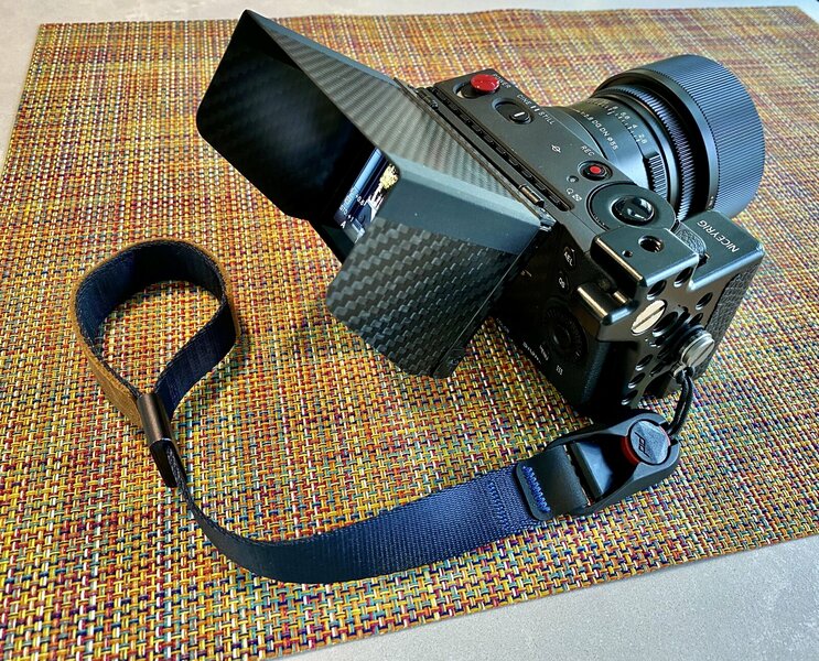

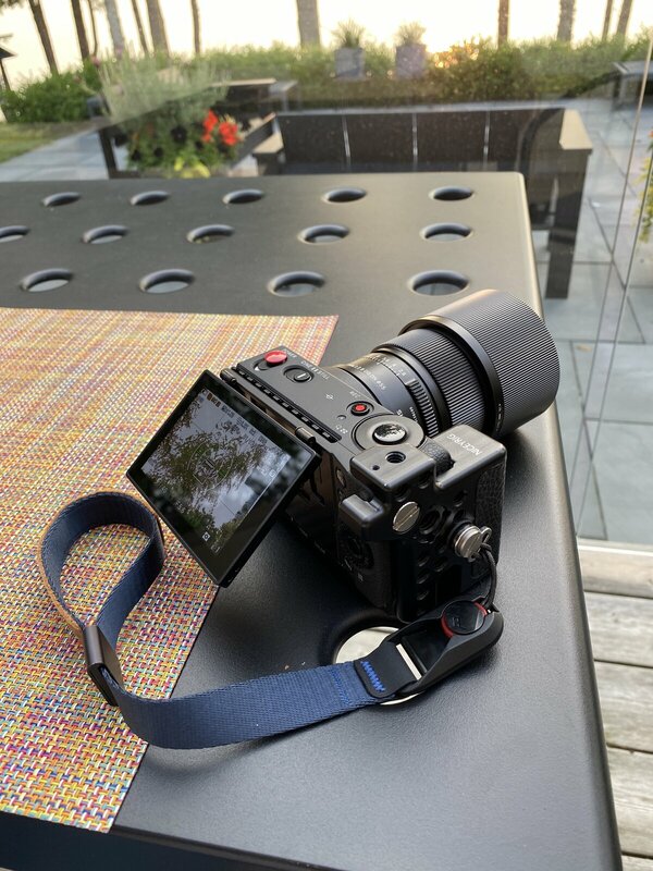

I have been using the FPL for awhile now and agree it’s a bit quirky but as a stills shooter it’s very easy to set up to your own shooting style. . One thing I‘m trying to avoid is the add on EVF as I feel it is too awkward and spoils the cameras ergonomics.
To get around that I’ve purchased 3 Sigma contemporary primes with auto focus and I’ve just installed a flip screen kit that comes with a removable sunshade all in carbon fibre,very light. I’ve also attached an aftermarket grip that I feel is better than the ones offered by sigma. The sunshade is reminiscent of using my old Rollieiflex . Not pretty but good in a pinch.

Hi. Where did you get the flip screen kit, and if you use the fp-L for video, how is the Phase detect focussing? Cheers, Colin
Hi Colin,
the kit is from a company called “Dark Power laboratory. You can find than on the web and on YouTube. If you watch the video of how to install it you will see everything is provided except the solvent to soften the glue that holds the screen on. All the parts are carbon fibre and fit perfectly.
I don’t shoot video so I’m unable to comment on how phase detect works for video. I can tell you that I’m very satisfied with how it works for still shooting. Here is an example from our garden . I just composed and clicked the shutter. This photo was taken with the 45 f2.8 sigma contemporary lens.

Hi Colin,
Thanks. I know of Dark Power Labs. I wondered if it were them. I'll look into it. I have had the fp since the week it was released. Absolutely love it but I need more reliable autofocus and was thinking of getting the fp-L as well. There are no good reviews on the focus which is frustrating. The image quality from the fp-L is extraordinary.
