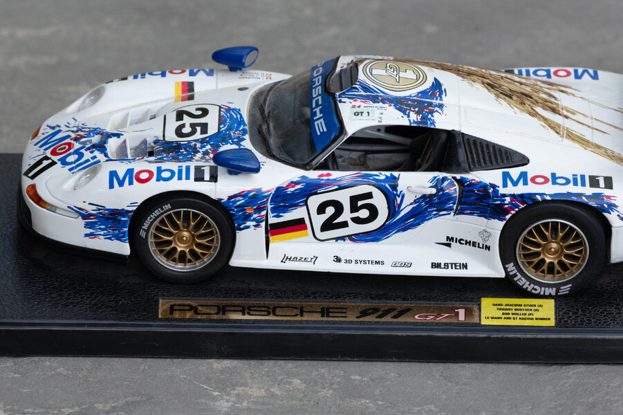

That is a good article, thanks. My thought is modern AI upres can trump a 2X teleconverter.
That's an interesting conjecture. Anyone fancy doing an experiment??
I've been thinking how to do a meaningful test that would show uprez well on this forum. Ideally one could have a resolution test chart setup and compare the line pairs per mm numbers between an uprezed photo and a photo with a 2X teleconverter. But I don't have a test setup like that, and don't intend to build one. In the past I've compared the hi-res functions of Panasonic and Sony cameras to the non-hi-res photos that are uprezed with an AI scaler like Gigapixel. At 2X they have virtually identical resolutions. But the case here is diffferent, it is about taking a taking a picture with, say a 200mm lens, and uprezing it 2X with an AI scaler and then cropping it in half to emulate a 400mm lens photo with the same number of pixels as the original photo.
A problem, I don't have a 2X teleconverter for comparison. Another problem, this gives photos with way more pixels than this forum can handle. But I'll do an uprez example anyway, to demonstrate the process. First, I've never been a fan of Gigapixel; it doesn't handle Panasonic RAW, and it doesn't handle images with fine text well. But I really like Lightroom's Super Resolution mode - it does AI uprez right.
For the test I used the Panasonic 70-200mm f/4, set to 200mm, and my S1RII, and photographed a model race car. This gave a 8144 by 5424 pixel image. Then I made a copy image and uprezed that X2 with Super Resolution for a 16288 by 10848 pixel image. And then I cropped this larger image in half, back to the same pixel size as the original image, 8144 by 5424 pixels, to emulate a 400mm lens. Then I exported both of these images at 3000 by 2000 pixels to use on this forum; they still look pretty good. Here are the results:
200mm photo
Emulated 400mm photo from the same image
